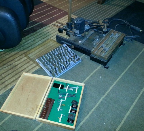

I bought an old pantograph style engraver in the hopes to use it for labeling panels on my electronics projects.
It an old Green model 106 which is a good machine, it was built in the 1930s.
I bought it on eBay, it seemed like a good deal as the ad placement was bad and it saw little action compared with 3 others I made plays for. I got it for about half the going rate.
I unboxed it and aside from it needing a new bit it looked OK.
Then I tried to use it...
I could not locate a bit to fit the spindle anywhere...
The bit required is an 1/8 inch bit with a #1 Brown and Sharp taper... 1/8 inch is easy, the taper part was impossible.
So I chilled on the project for a month or so while still looking online for bits...
Then it hit me I have a machine shop in my back yard, modify the engraver to use current readily available bits.
I don't have a lot of tooling such as a slitting saw and arbor yet. but I got an idea. I have an old Bluepoint Die Grinder, it has a 1/4 inch collet. So I started to work with that.

The collet from my dead die grinder and the original spindle, bit and retaining screw from the engraver.
I turned the air motor shaft to a #1 Brown and Sharp taper only to find the slotting for the vanes went too deep for me to bore and thread for the original retaining screw.
Back to the drawing board...
So I made a new spindle complete with the threads to mate it to the collet.
The lower is the old spindle with the air motor shaft I turned the taper on.
This lets me run the 1/4 bits but not the 1/8 inch bits. But eBay comes to the rescue with a collet adapter.
I have used both the 1/4 and 1/8 bits only to discover that the font included does not fit the machine.
Sooooo... I will be making my own fonts when I finish up my CNC mill
