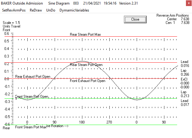

Please may I stick my oar in and ask for some advice? I am in the process of laying out Baker gear for a 1 1/2" scale mountain loco and am using Mr Dockstader's software. As has been discussed earlier, it is not instantly obvious to use but I have persisted and am getting the hang of it such that I have a potential solution. The question now is what constitutes a good solution? What are good valve events so what am I trying to achieve? I want about 1/64" of lead so in mid-gear I get this:
The lead is fine and, although the laps are different, I can make the valve to suit. Here is the Sine chart as well.

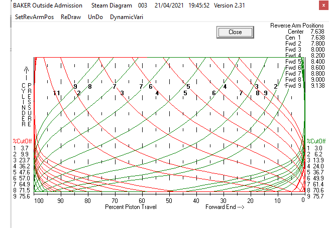

I set up the steam chart for nine reverser positions from mid to full forward gear and get this.
The chart doesn't tell me a lot but comparing the cut-offs between front of cylinder on the right and rear on the left, they are not identical but almost match my 75% cut-off target in full gear. (Don Ashton's recommendation). They do diverge in the mid-range so my question is, is this significant and will it matter?
As you can see below for the same set-up but in reverse, they differ more significantly and you can see the bias in the shape of the chart.
I just don't have a feel for what are 'good' valve events so I would very much appreciate some views.

Here’s my 2 cents for what it’s worth, at least worth messing with on the program. First of all, I would try and get the laps and leads equal, the the rest of the valve events will behave much better if you do, especially when hooking up the reverser. Lap is a product of valve dimension, but lead can be altered by the combination lever. If you would like, I can include 2 simple formulas that will help you get the exact points you need. 1 from the greenly/Evans book, the other from the original ICS books. Once you enter these in, I just adjust the Union link with the gear rolling slowly in center a thousandth of an inch at a time until the leads/cut-offs are equal. I would also just choose a decimal point for your lead instead of an exact fraction just to make it easier. .015” or .016” will work well. 2nd, I would recommend making your full cut off closer to 85%. I don’t know the prototype you are modeling (except that it’s a mountain) but most American prototype locos had a cut off around 85%. Some higher some lower. Ashton’s book is interesting, but you have to remember the British were much bigger into economy than we are. And most of their live steamer tracks were flat compared to ours. Some American fast freight engines were around 77-80% cut off, but most stuck around 85. Mountain climber got as high as 88-90. The berks were 79-80 I believe. And 3rd of all concerning the cut-offs you are getting, your valve events actually look pretty good. Something to remember with Baker, it usually give unequal port opening front and back, and always give unequal cut-offs from forward to reverse, it’s just the nature of the beast with baker. The berks right out of Lima had pretty unequal valve events, yet they worked well and sounded fairly square. Although when flying hooked up super high, they sounded more like a gallop than a helicopter. But obviously, their overall performance was never affected as they were phenomenal fast freight locos. Hope this helps, let me know if I can help further and I will try my best.

The prototype is the Frisco 1500 class but an early one with Baker gear. Baker gear is pretty rare this side of the pond and very few people have experience of it so I have been struggling. As you can see, I have managed to get the lead even within a thou but I was very surprised that the laps were different. I used a Bilgram diagram to identify the lap dimensions and this generated differing figures front and rear. I did it several times and came up with the same answers each time. I believe that it is due to the effects of crank angle. Should I just take a mean figure for the lap?
It is very nice to hear your comment that Baker gives unequal cut-offs forward to reverse. That is exactly the sort of gem I have been after because I don't know what to expect and whether it is just my incompetence or it actually does that!
I shall run it again and see if I can get 85% and also see what happens when I adjust the lap. I will let you know how I get on.

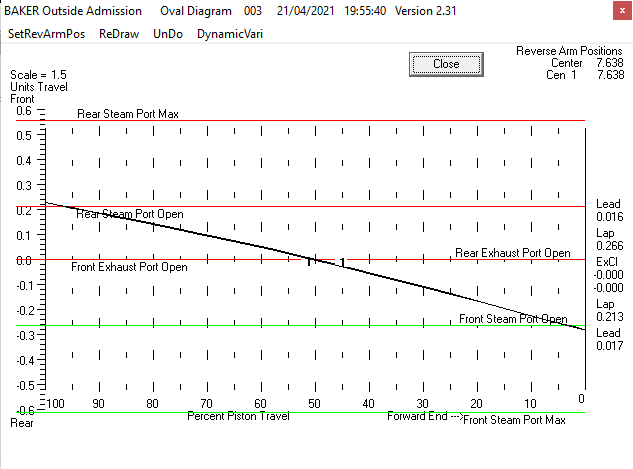

I am still playing with this and looking at the lap at the moment. As I said before, I have used a Bilgram diagram to work out the laps and came up with different values front and rear. They gave me this chart which has the same settings as above:
You can see that the exhaust ports open at the 50% piston stroke position.
I then took the mean lap, changed the valve dimensions to achieve this value at both ends and got this output, again for forward gear:
Now, the exhaust ports open at the 45% stroke position in mid gear. All of the openings are biased with the piston closer to the front end although it seems to be less significant as we approach full gear. I suspect that there will be little effect so think I shall make the valves like this for simplicity sake. What do you think?
Full forward gear here is 75%. The next thing I shall try is to achieve a longer cut-off. Watch this space!
Steve :)
