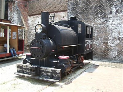

In 12" = 1'-0" scale, we had a little Porter 0-4-0T at the museum - I mean TINY for standard gauge. That area was packed full of what I now believe was used moulding sand. It was really hard to dig out. The smokebox was open to the cavity for the steam & exhaust piping, so the sand was probably the easy way to seal it off and reduce the volume of the smokebox/saddle combination.

Possibly, but this casting had a steel plate bolted onto the bottom that was the whole size of the saddle, and the sand was packed around the steam/exhaust pipes.
The sand was tight against the steel plate and the pipes.
