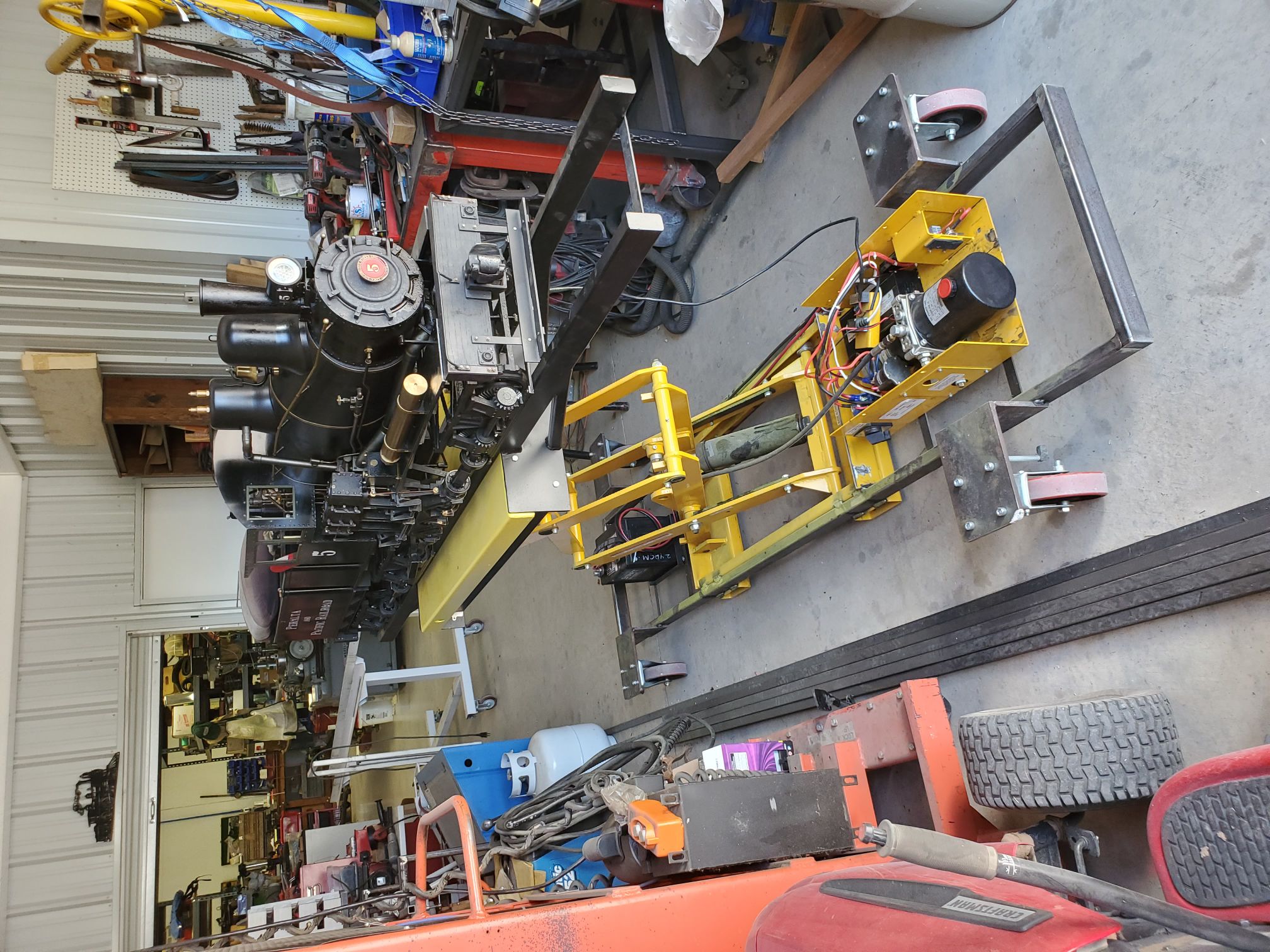

Lift does need to be moveable.
- Attachments
- One of several
- IMG_22052022_075154_(400_x_400_pixel).jpg (44.23 KiB) Viewed 4621 times

I'll toss in my hydraulic table, even though you're looking for non-hydraulic options. I considered various other lift options but all lists have their issues and in the end I went hydraulic for the speed.
I made this from a surplus (bought for $400) 1000 pound lift table from Vestil. It's battery powered and pretty handy:
https://www.kepler-eng.com/images/lift_progress_15.jpg
I moved the power unit and battery out to the ends, cut and inch and a half from some structure on the sides to get the main beams about 3/4" from the ground. I added .120 wall 1x2 rect tube about 8' long on both sides and relocated the casters to nearer the end on outriggers to increase stability. The 'rails' on the table top are simply bolted in 1x2 hvy wall again with a brace under the table and 1/2x1" solid connecting across the top.
I put my Shay on it:
https://www.kepler-eng.com/images/lift_progress_13.jpg
and it had no problems moving it up & down. There's a little bit of tilt when the scissor under the table switches sides, about 1/4-3/8" at the ends of the rails.
I'm just finishing my loading pad so don't have a lot of time on it.
(I removed the embedded images because the system bitched about the width, sorry but you'll have to click on the links)

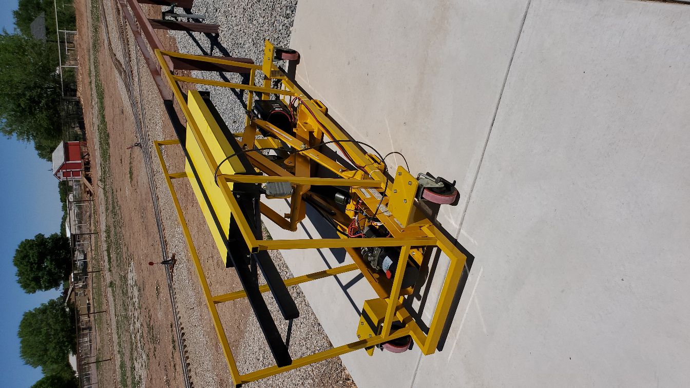

Re: Lifting transfer table.
I purchased three electric/Hydraulic Lift Tables off of eBay over several years.
Two were used, one brand new (the yellow one).
The brand new, had no delivery charge, the seller was only 20 miles away, and was happy to bring it over.
The two used had shipping costs almost equal to their cost.
Two are used by the two turntables I constructed, (https://www.youtube.com/watch?v=cu7Cou5zVi0), the third is my welding/assembly table.
